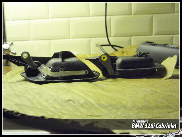

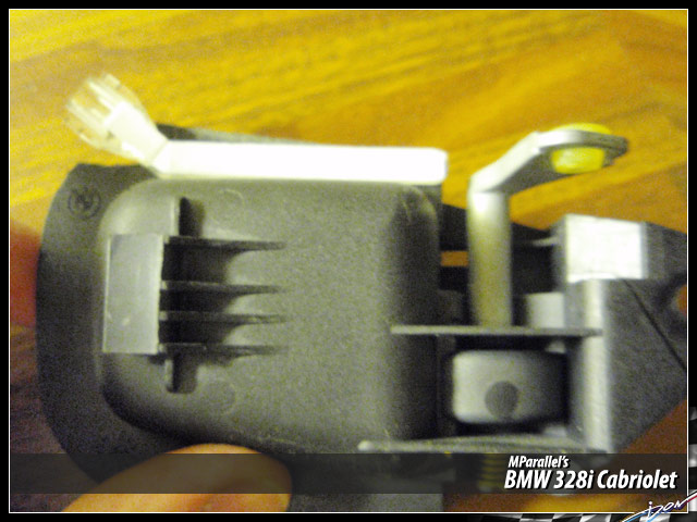

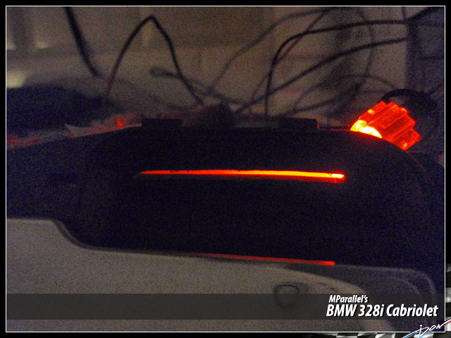

Сообщение от dancer_st Посмотреть сообщение

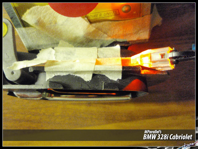

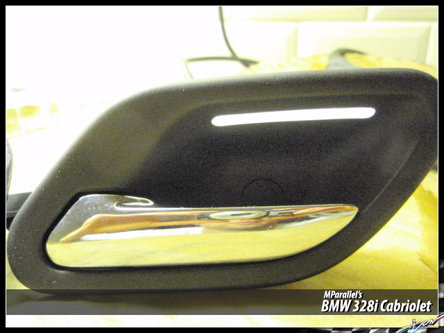

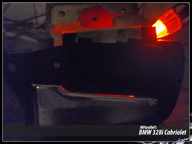

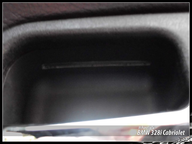

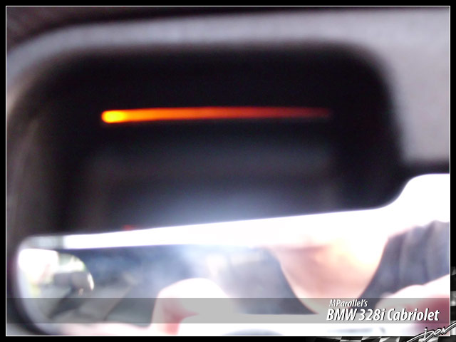

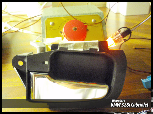

блин... тогда сейчас фотки от туда повывешиваю )
автор данного: MParallel (Netherlands)
So I took an OEM handle of E39/E38...
...which have a perspex strip on the back, with a holder at the end in which you can click a Led (you can get these seperately and are perfect for placing OEM amber leds anywhere in the car).
So the question was, how to make these strips fit the E36 handle, which is MUCH smaller.
First I took the strip out. Dremel'd off the mounts, shortened them a bit.
First test
From above
In the dark. Here the effect isn't seen so good, as the handle isn't behind the door card and so the led is here fully exposed...
From underneath. That slot was very hard to dremel out. It had to be straight and perfect the first time (I practised on an old set first) Afterwards I used a small nailfile to grind off the burrs.
Strip is glued on with hotglue.
Final result
Off (the strip sits on top, so no flextube in the cavity)
ON
если я правильно понял все взято от е38-39
